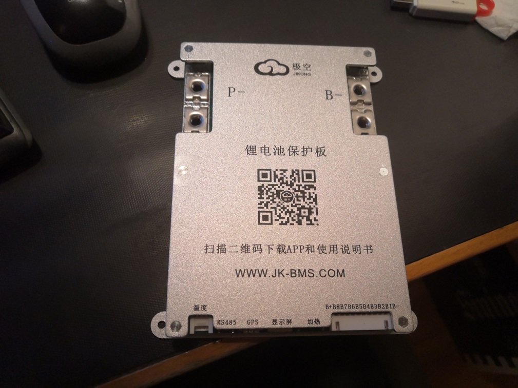

Mun bms tulikin tänään, akuista tiedä millon tulevat...
Bms on tän näkönen, aika paljon liitäntöjä on. Ja otin tosiaan siihen sen 4" kosketusnäytönkin mukaan, kun en jaksa puhelinta oikeen käyttää.

That's the old style JK (although the original one had the black case, the 16s and over still do). I run 8 of them, some of them for 6 years now continuously without issues.
Sounds good, perhaps this do its job for me also. If that PC software don't work with these older ones, i forget rs-485 adapter. I really don't need it, when the display unit shows all necessary.
