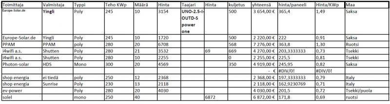

nikfly
Ohessa on lista tarjouksista joita olen haalinut kasaan nyt keväällä..

By the way, I have briefly price calculation for the set of 2.45 kWp (10 Panel of Yingli + UNO-2.5-I-OUTD-S + Mounting system(est.)).
So, the price what we would like to offer you is about 2650 EUR (nett)* for this set.
Estimation of the transport will be about 400 - 600 EUR.
